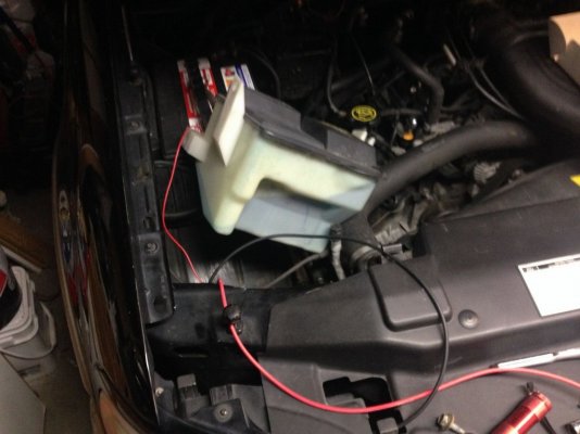

Added a USB charger to the dash. This one has a 3 amp charger as well to handle ipad charging duties. Those cigarette lighter adapters I've found to be hit or miss- especially in bumpy conditions.
I added a switch because that bright blue light is on anytime there's power applied.

My nitpicking mind likes how you followed the existing curved line with the outer edge of the charging port. Well done.
Interesting though, I'd have likely just colored over the light with a sharpie hahaha
ExplorerTom
ExplorerTom
Apr 2, 2015
2,244
991
Colorado
Yeah I was trying to match the 4wd switch with the location.
And really, there's a rubber cover that goes over the USB holes that covers the light that would work just fine. I got the switch when I thought I was going to tap into the dash power point that is always hot- but getting to those wires was more disassembly than I was looking for. I tapped into the dash power point on my Explorer for this install so it's roughly the same.

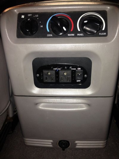

Here's my Explorer:
One of these days I'll upgrade the audio in both of these trucks to the 21st century.

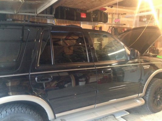

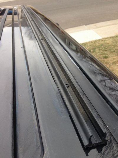

Put the side trim back on. Went from this:
To this:
It might be back too far by just a hair, but it's pretty close. I used some 3M moulding and trim tape. I used a heat gun to soften up the old tape to remove it completely.
