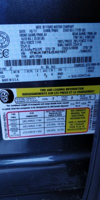

This is the tire and loading sticker as requested for my 07. Note my curb weight is 5,805 pounds.

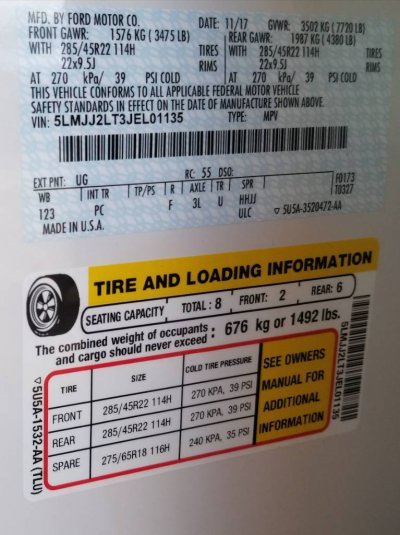

Just looked at a Navigator Reserve 4x4 with the tech, tow, and massage seat package. Here's the sticker. 4b9a64d3bd9f92038a66340a625b9bc9.jpg

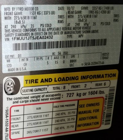

Finally found an Expedition in stock. Apparently these have been selling like hotcakes. This one was a base 4x4 XLT with only the panoramic roof added. Payload is 1604 lbs, 80 lbs higher than the 2WD Platinum posted earlier. 0e8d01ec779933afd796161477019784.jpg
Edit: I'm not sure how loaded your XLT is, JExpedition07, so the new ones look to be ~150-200lbs less capacity than the 2nd generation Expys. Not great but at least not 500 lbs less like originally feared.
