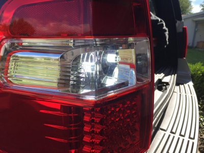

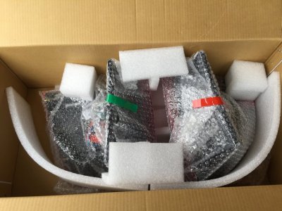

My LED tail lights arrived today. I'll post a few pictures tonight and I'll show the install. Planning to install them tomorrow if the rain ends. The lights were well packed and cushioned.
They look much better in person than they did in the pictures on the website. I'll post more details as I get into the install. This is just to kick off this thread.
The tail lights were securely packaged well enough to keep them from hitting in transit.

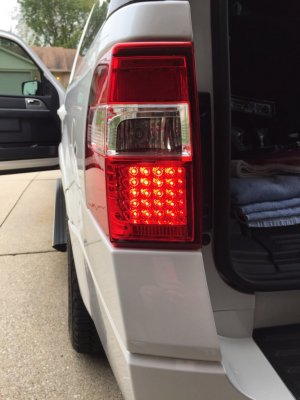

Straight on view of the Tail Lights
Side View

They look nice.

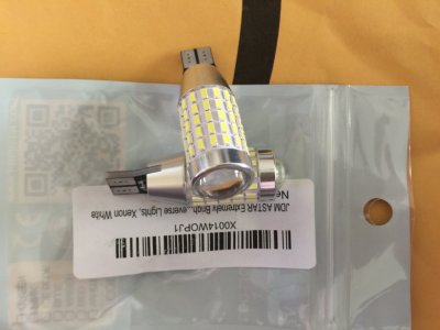

I installed them yesterday and they went in without a problem. My backup LEDs will be here today and and after I install them, I'll post pictures and a how to install here.

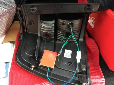

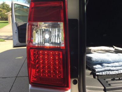

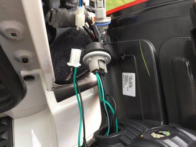

Yesterday I installed my LED tail Lights. They are very bright I am hoping to shoot a video that shows them in action. I'll have to wait until my daughter gets home from work so I'll post it later.
The back of the LED tail lights look just like the standard tail light except for the LED array on the front side. In this picture you can also see the sealed resistors that come with the tail lights.
You start by removing the the two screws that hold the tail light assembly to the back of the truck and then pull back to release the pins on the back side that plug into the body. Once I removed the factory tail light assemblies I disconnected the light bulbs and I installed the resistor that came with with the LED tail lights.
I found a place to locate the resistor in an area away from plastics. The resistor came with some very sticky double sided tape. I found a flat area up inside the opening above the tail light and stuck it there. I mounted it high enough to keep it away from water.
I plugged in the connectors and and the backup light bulb.
The finished tail light looks pretty good.
