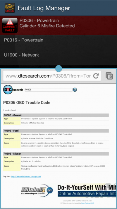

    UPDATE
    Consistent code for misfire on #6 - swapping coils doesn't move the code.
    Worried about breaking the plug without having the tool. Posted to local forum and guy comes out and confirms #6 misfire and gets the plug pulled.
    It was a 5/8" champion plug that was extremely loose...
    Popped new motorcraft plug in and runs great.
    Now I have to check/change the other 7
