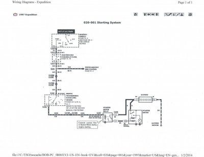

My expedition was running great until Friday afternoon when i went to start it on my lunch hour it wouldn't turn over. Battery and starter are fine. I am able to start it by jumping the two bolts on the firewall with the solenoid using a pair of pliers. I tested the solenoid and it has power from the ignition best i can tell. Anyone had this issue too?

You stated " I tested the solenoid and it has power from the ignition best i can tell"
Saying best you can tell sounds like a guess How did you test it and what was the voltage?

I used a simple hand tester to make sure it was getting power to it. I did not test the voltage, I can check that and get back to you. Thank you!
