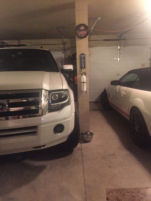

OK- I hate to do this. But I gotta get better headlights in my 2009 EXP
