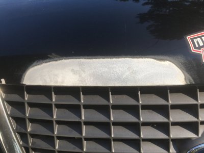

I also have alot of bubbling and corrosion on my 07 Expy. I was wondering, are there any aftermarket replacements for hood/hatch??
There likely are (ask the local body shop), but if you replace them with Ford OEM parts and have them painted at a reputable repair shop you should have no more issues. Reputable shops will ensure that it's prepped properly and they won't paint an oxidized surface as Ford did. They will also give you a limited lifetime warranty on the paint.

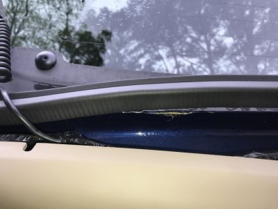

I have been told by 2 professionals, that it can be fixed, but not by conventional methods
  • Remove tailgate
  • Remove all glass and trim
  • Sand the entore door. Use putty to fill in any voids.
  • Sand blast the inside
  • Clean well inside and out including a tack cloth
  • Prime with zinc chromate primer
  • Paint
  • Let dry at least 12 hours before reassembly
  • Inner seams should be sprayed with some kind of oil based anti-corrosion like Fluid Film, repeat every year or two.
Both people claim they never had any come backs.

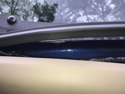

I have a 2013 Expedition that has lots of paint bubbling on the lift gate and since it has over 36,000 thousand miles on it Ford said they would cover half the repair. This shouldn't be happening to a 3 year old vehicle that has a $50,000 list price or any vehicle this new at any price. They obviously have known about the problem for a long time and have chosen not to do anything about it. As a loyal and long time Ford customer I am truly disappointed and it will definitely affect my buying decision in the future. Why would anyone buy a new Ford truck that is all aluminum when they can't, will not or are unable to come up with a solution for bubbling paint on a aluminum lift gate and when there is a problem, are not willing to cover the cost for their mistake.

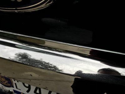

Just got a 2008 Expedition Limited and noticed the paint bubbling on the tailgate. Where do we file complaints at?

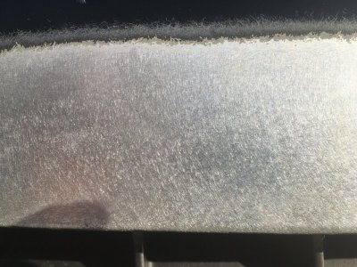

So I was just washing my 2011 and noticed bubbling on my hood. Some bubbling just above the grille on the hood and another spot up the hood right below the windshield... Is this really happening on a 2011 with only 26000 miles on it? Anyone have the e-mail address to file the complaint?
Sad, been looking to buy a newer expy in the 2011-2013 range and I've looked at about 10 so far, all of which have rust on tailgate. I had this issue with my 2005. How is it that Ford cannot get this corrected after all these years.
