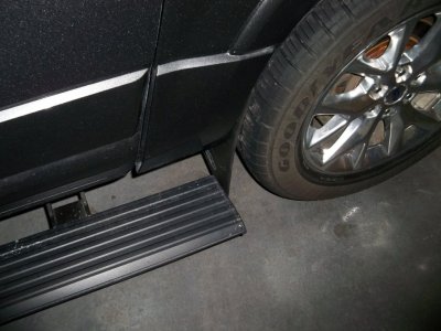

Trying to figure out the best route for mudflaps on my 2015 Expedition Limited. I have not found a set that is advertised to fit the front due to the power running boards. Ford advised they do not make them for the Expedition (according to my dealer). One question I have is can the boards be moved either left or right? It appears there's a couple of hex nuts on the bottom of the brackets that might let you adjust the boards to the left or right. This might help in giving me a little, very little, more room for the boards to deploy without interference with the flap. Any help would be greatly appreciated. Thanks, Tater

Here is the part number that fits my 17 Platinum with power running boards. FLIZ16A550A. They are avail. on ebay for $29.00

That's the same part number I gave the dealership. They stated they would not work with the power boards. Would be nice if they knew what would and wouldn't work. Thanks!

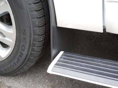

Use a normal flap
For the front and add a small spacer behind the flap to push it out enough to clear the amp boards. Other guys here have done this. Simple, uncomplicated and it works.

Well, I had already ordered the Ford OEM ones off e-bay. I sent a message to the seller who stated they would fit as they hang straight down not interfering with the power boards. If they don't they will be going back. I'll post when they arrive and get a chance to check the fit.
