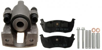

    Raybestos "loaded" rear calipers (includes pads and all hardware), part #RC10912 and #RC10911 are only $64 from RockAuto (not including shipping and after core return).
    The fronts, part #RC10910 and #RC10909 are $75.
    I highly recommend Raybestos Advanced Technology rotors ! They are mire expensive, but the don't warp like cheap rotors.
