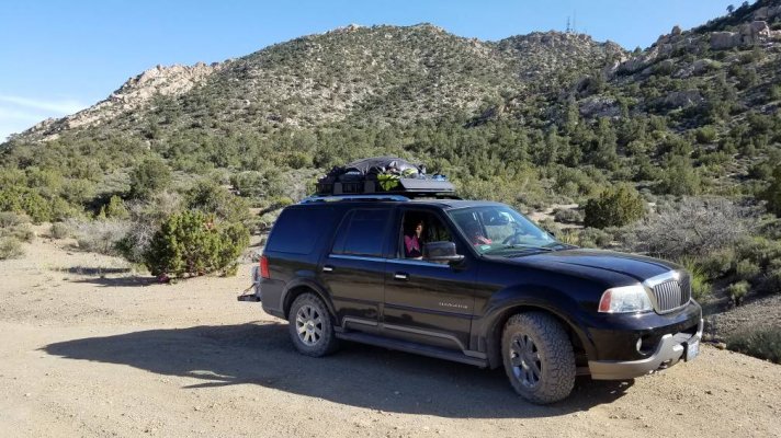

Long time listener. First-time caller.
I'm planning to install the 3/2 eBay lift and a set of Rancho Quicklift struts on my wifes 04 Navigator Ultimate. Basically the air ride suspension is failing and I would like to take the opportunity to make her rig more capable.
I've confirmed that struts are the same between the Navigator and Expy but Rancho's website only shows parts for the 2007 (3rd gen) and up. I see that @waldo and others have used them on their builds. So I thought I'd use my first post to ask the collective some questions.
Are the struts the same between 2nd and third gens?
If not what part number did you use?
How have they performed for you?
