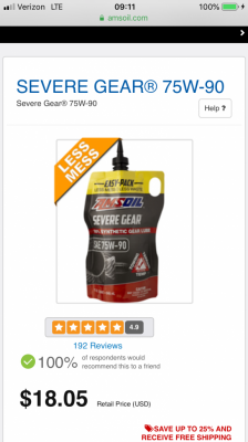

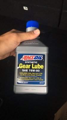

I used Amsoil 75-90 Severe Gear Oil I do not believe Amsoil makes a 75-85.
I used Ford Motorcraft Friction Modifier.
I believe Amsoil is call Sliploc I have never used it as strangely no one carries it locally.
