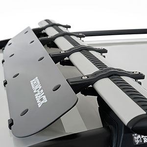

3D carbon made one for the FMF Expedition. Not sure if they sell it separate or need the buy one of the kit options
USMCBuckWild
Oct 21, 2016
495
178
Camp LeJeune, NC
A friend of mine had a front mount Yakima air deflector on his Subaru Forester that mounted to the front cross bar, helped reduce the drag from the rack up there. He attached it to the rear cross bar for the exact same reason. Don't see why it wouldn't work for your application.
