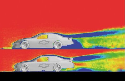

we have a huge wind burble area on the rear window and liftgate, i imagine its not enough to change mpg, or ford would have made one, but it may be enough to keep rear window cleaner.
the burble does help aerodynamically speaking as it forms a bubble that allow the rest of the airflow down and around the flat side of the rear end,

burble/bubble or rolling air flow that acts like an object, in relation to the other air around it
that is the swirling of air that occurs off a sharp angle break, like in our roofs to the lift gate is a sharp edge and it creates burbles/bubble or rolling masses of air, its almost a solid that it will cause air flow that is not part of the burble/bubble to flow past and gain some streamlining effect.
best way to see it in action, is in the rain watching air flow around a semi trailer
or some wind tunnel videos
