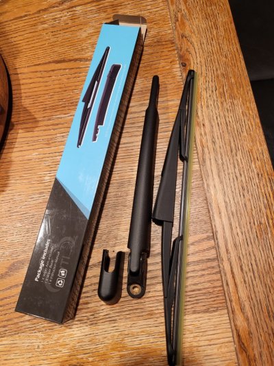

I just did mine for just over $30. The only thing I didn't like is the new piece that fits over the stud and gets the nut tightened over it is PLASTIC with no teeth. It's smooth on the inside and I hammered it on and tightened down as much as I could without breaking it.
The old arm I removed was metal with teeth to fit perfectly over the toothed stud.
New one worked fine when I tested it, just wonder if it's gonna eventually wear down plastic and require a rework.

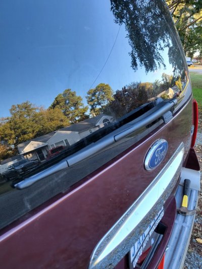

I have a june 09 build 2009 expy eddie bauer. It looks as if I already have this wiper? Either previous owner did this mod or could it possibly have been a job 2 change over in late 2009?
