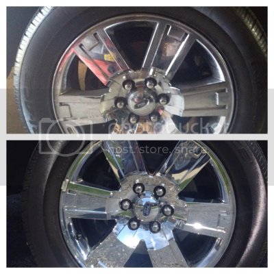

I ended up using #0000 steel wool to clean off the surface spots and polish it then used Eagle One Nevr Dull. I was hesitant at first with taking steel wool to them but it did wonders. It is a great way to clean chrome rims and I will probably do this periodically to make sure they don't ever look like that again. From even 5 feet away they looked great before, now they really shine. They almost looked photoshopped in the picture of the whole truck. Here's how they turned out.

Did you use any kind of compound with the steel wool or just water?

I made sure the wheels were dry, and make sure you remove all the steel wool remnants with a microfiber towel to get it all or you will have rust spots after it gets wet. These wheels had been severely neglected, and this method was not quick as it took me about an hour per wheel. But the results were worth it.
