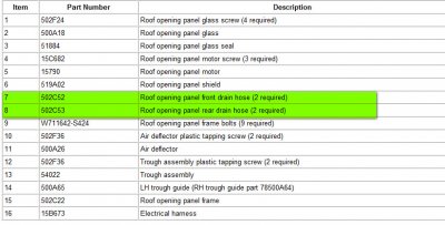

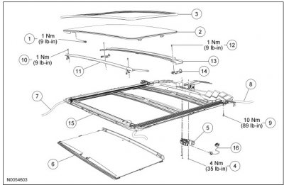

Just bought an 06 expedition ,so new to this forum. The driver side floor is wet and did some searching and found it could be the drain holes on the sunroof. Also where the back seat goes into the floor, those indents are also full with water. I found two drain holes in the sunroof on the front of the sunroof are there any in the back. Am I on the right track or should I be looking at something else. Thanks

So do I need to pull head liner down to get at the 2 back ones

no
if you remove visors , you can open sunroof and slide your hand to get to the tube, just be very conservative at how much you manipulate the headliner
