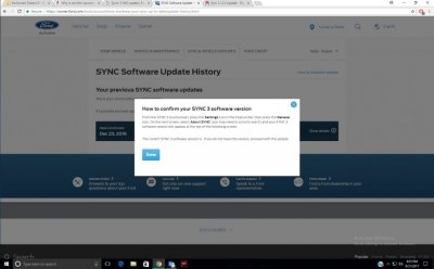

Here's what Ford says the latest version available for my vehicle is:
I love the part that says "The current SYNC 3 software version is ." Its blank.
