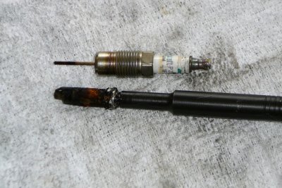

...to replace the spark plugs in my '07 Expy
With just over 103,000 miles I anticipate there will be a fair amount of carbon build-up in the combustion chambers.
To prepare I have been adding cleaning/de-carbonizing products at every fill-up for the past month. I have used several different brand products including Seafoam, GumOut, Lucas & Risoleen (sp?) For the final treatment I'm ordering Yamalube **Ringfree. Normally I would not have used any other product except Yamalube Ringfree. However, I didn't have any on hand & due to a condition known as "Chronic-Procrastination" I failed to order any in time to begin "treatment".
My hope is that carbon build-up on the end of the spark plugs will have been reduced if not all together removed so as to prevent the all to common issue of the spark plugs breaking off while still inside the cylinder heads.
I will use the recommended method of cracking the plugs a 1/4 turn then spraying a decarbonizing/cleaning agent around the base of the spark plugs & allow them to soak. I will let them soak a full 24 hours or more before I attempt removal.
I plan to install Motorcraft Sparkplugs. I know Champion makes a one-piece plug that would be great but I am no fan of Champion plugs except in chain saws, outboard motors & similar applications. Autolite has a plug manufactured specifically for the 5.4L engine.
Who has used what brand spark plugs & any comments/suggestions, etc?
