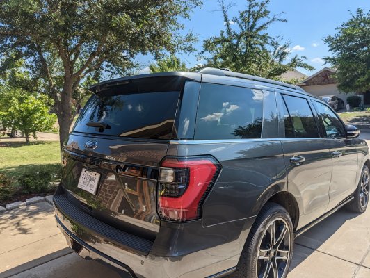

If it hasn't changed much, I'd do the belt line yourself. 2" strip goes on easy, wraps and trims simple. I did mine in an afternoon easily. No way it's worth that much money, either DIY or call another place. Hardest part is around the back corners with the complex bend but a little patience and heat will get it done.
Here's an in progress pic to show the difference.

Someone else has posted that the rear trim along the hatch can be removed. That's info I wish I'd have had prior to doing this because I could have taken it inside and done it there. I did do it all on the truck. My Amazon heat gun has come in handy many times and it came in handy for those corners. Sides were done with no heat and all I did was clean the chrome with alcohol prior to applying them to make sure they were clean and dirt free. Around under the mirrors was a smidge tricky but it wasn't bad at all. I did use a squeegee and a cutting tool to get it applied correctly, but with the narrow width of this you can mostly use your fingers. The squeegee was handy for pushing it around the top and bottom and getting it tucked properly for a nice finish.
Note, I didn't realize on that roll of vinyl that there's a protective clear cover over the black to protect it during storage and application. I didn't realize and thought it looked terrible, then found it peels right off leaving a beautiful finish under it.
Another during shot.
You'll have plenty of tape on that roll that you can do some practice runs, but I suggest starting with the passenger doors as they are straightforward and working your way from there.
