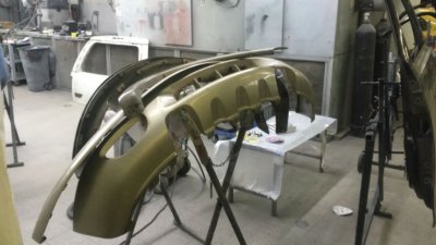

As I can see in this "Heritage Edition" they colored the bumpers too. In my case, I'm planning to stay with initial champaine bumper.

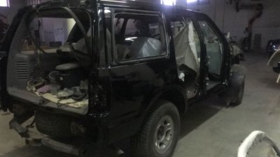

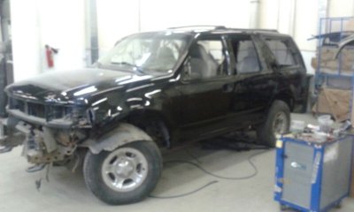

Hello, everybody!

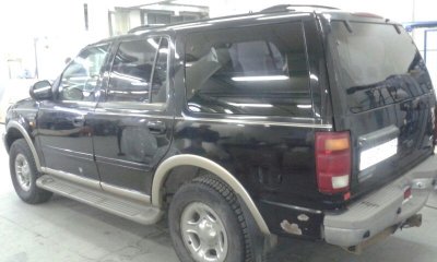

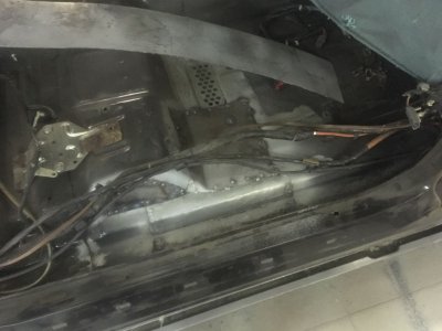

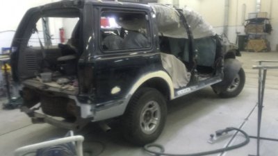

It is already about two weeks, since my car is in the bodyshop, waiting its renovation. While prepearing it to the paint works we have faced some obstacles, wich is quite common for those cars, which are "living" in Russia:
Bigmac
Bigmac
Dec 26, 2015
52
Moscow city, Russia

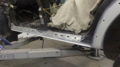

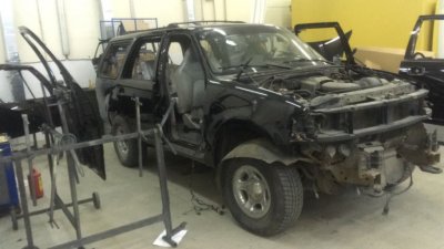

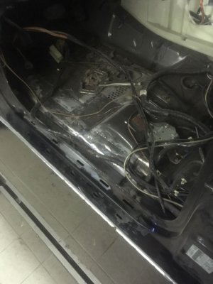

Don't be scared too much, this is quite normal for Russia, never mind whatever car you are driving here. I've bought this car new at a dealership in 2001 and because of usage of plenty of different acids on the roads in Moscow (Russia), you can see the result...
So, now the idea is to change these floor thresholds for the new one and only after that start to do the main job.
reece146
Apr 22, 2012
272
21
ON, Canada
Yes, might as well get them to do the rockers (thresholds) now while it is being prepared. Thankfully, that is a fairly straightforward job. Probably 3-4hrs / side labour I'd guess.

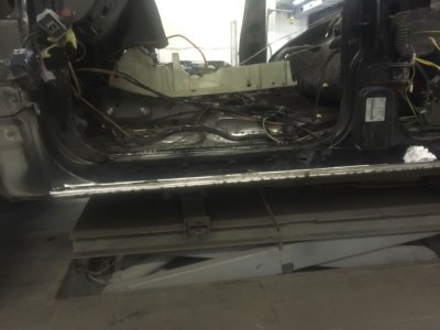

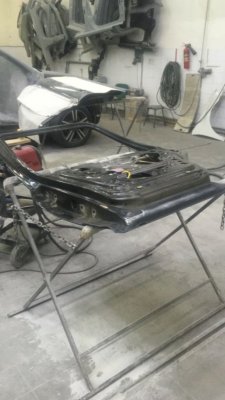

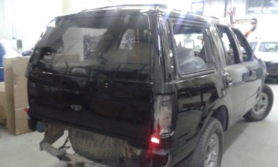

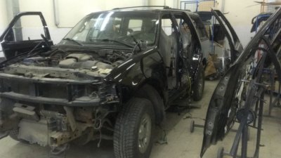

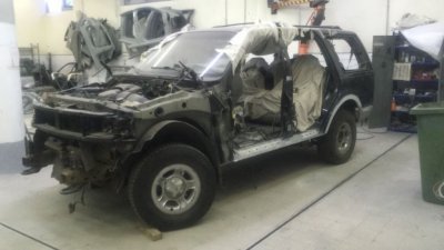

Sorry to say, but, everyday situation become worser and worser.
Every new attempt to explore the new far places of the car, made me totally dissapointed.
Just have a look on this shit:
Bigmac
Bigmac
Dec 26, 2015
52
Moscow city, Russia

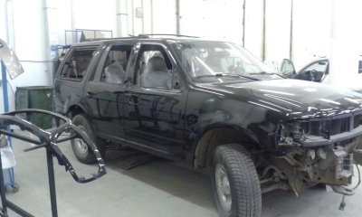

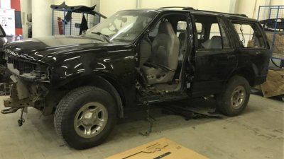

The idea was to make this car more attractive, but there is no stuff to deal with:))
First I need to create totally new car and only after that...
tcwaltz
Jun 20, 2016
200
50
Niceville, FL
Rust is common here also, especially up north. I'm in the south and we get it because of the proximity to salt air. I've had rust floor boards and the like for years in varioius cars. Cut out the bad metal then treat it. Use body panel adhesive to glue and rivit the repair sheet metal in then treat it. I had some rot in the passenger side front where water collected by the radiator because there is one where for it do drain. The mount for the front of hte body is there also. Cleaned up the rot, treated the metal and filled with fiberglass bondo to make it look nicer since no one is going to look at it anyway. I also added drains in each void. The rocker panels you can buy I think.
My big repair was rust holes in the roof.

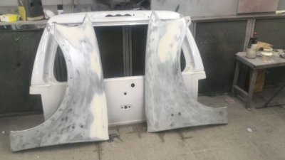

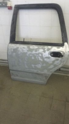

Hi, guys!

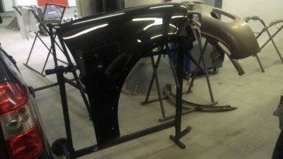

So, 2 days left and I'm coolled down a little bit about general condition of my car.
We even managed to find the new back door:
Quite cheap, I would say - 50$, which is much cheaper than restore the old one.
