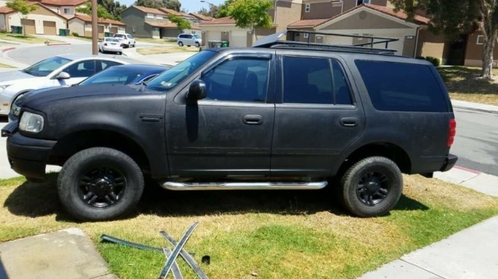

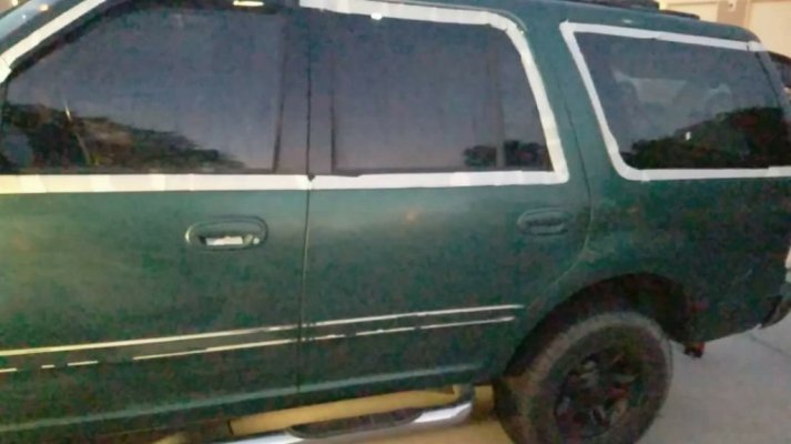

Here's before and partial after.
I got too tired and it got humid do I came in for the night. I'll post more tmrw

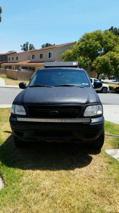

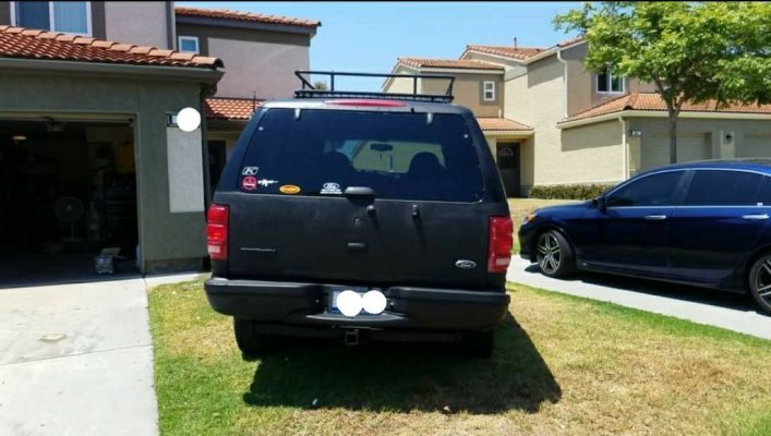

Here's what it ended up looking like this morning. I avtually am liking it. Super rough and feels really durable. Now time for the other side today. And roof good thing about this stuff is you can add to it and not worry about blending 030caea516df61a652b1fb10b2047335.jpg52d606c9ee594ba4d8125aed491f4d70.jpg29bd7cf6f9a1af7429abc361fac90da2.jpg

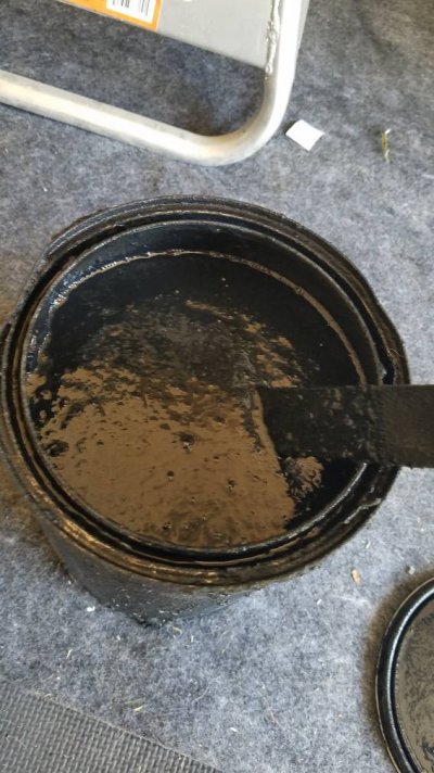

So here's some pictures of the can. I only ended up using half a can. I thought I'd use way morec9538ce57d2e44e50878afbd493c67d0.jpg
