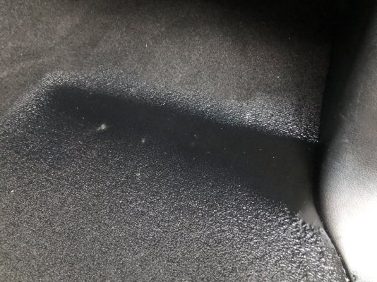

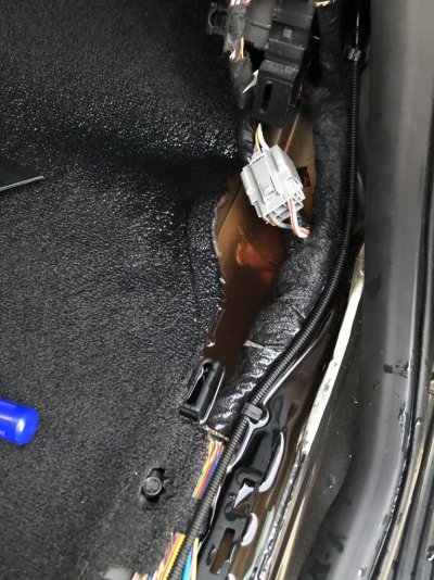

I then had the wet carpet issue big time after this. So I did that TSB my self installing that rubber elbow at the ac drain port on the firewall.
