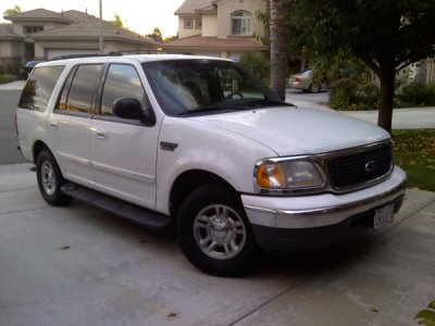

    Hey, i have a 2000 xlt 4x2 with aluminum wheels. Does anybody know how much torque the wheels lug nuts needs? I cant find it in my owners manual? I guessing 80-90 ft/lbs?
