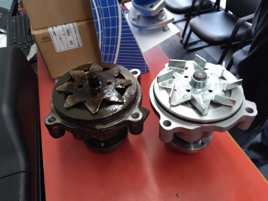

We’re still at it. It was blowing hot for a bit then it seemed to plug again. I’m guessing the cooling system was never flushed out. The old owner didn’t seem to do much maintenance. The shop said they flushed it until it ran pretty clear. I’m wondering if the water pumps blades have corroded to nothing so there not enough pressure to blow through clogs. When I drive it it will start blowing cold, but if I down shift for higher RPMs it will blow hot again. Should I replace the water pump? I’d love to keep the truck for a few more years, but without heat it will be a sad winter!
Aspen03
Apr 24, 2019
727
357
Indianapolis
That's an impressive amount of wear. I'd think that if it impeded water flow so much you got no heat that the cooling system wouldn't even be able to do its job or you just got very lucky with just enough flow for essentials
