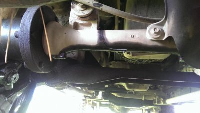

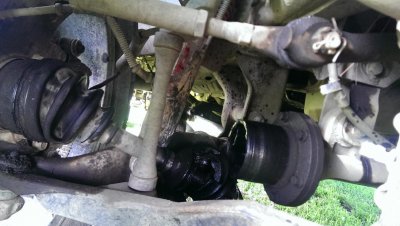

Hey guys,
I took my 00 Expedition XLT out offroading yesterday and went a little too hard. I need some help identifying certain parts that need to be replaced. I attatched two pictures with the extent of the damage. I already ordered the front outter cv axle, front shock. Now for the fun part. I didn't know the true extent of the damage until this morning. I broke the front right axle shaft tube that connects to the front differential. The front differential housing seal needed to be replaced anyways. What parts are needed to fix the inner part?
*Front inner axle (passenger side)
-what else is needed?
*Front inner axle tube (passenger side)
*Front differential housing gasket
*Differential fluid
Also, how hard is it to drop the front axle carrier? I'm mechanically inclined and have most of the tools needed. I assume I'm going to have to drop the front differential, disconnect the driver's side cv axle. Remove the differential cover, unbolt C clip to passenger side shaft. After that will the axle come right out or do I need a slide hammer? How many bearings are associated with fixing that side? How much fluid is needed after fix? What is the part names actually called? Sorry for the questions.

2000 expy does not have center axle disconnect if that is what your asking nor IWE's. They also come with open differentials. No locker or trac loc unit. According to my ford workshop manual you remove front axle assembly to replace the broken axle tube.
I would replace half shaft as a unit. Easier and fairly inexpensive.
You might consider a skid plate if they make one for the expy assuming you physically hit something with the axle.
Sorry about your misfortune but you should have posted photos on how and when it happened!! Impressive.
Some members here have CD roms with shop manual. Hopefully they will post steps necessary or you can purchase one online yourself. I purchased ford workshop manual (hard copy in print) and prefer to use it.
