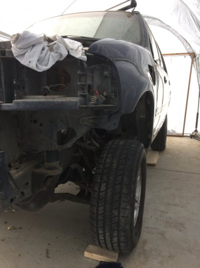

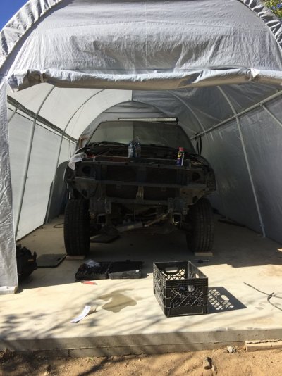

961260EA-2F01-4FE7-94EC-26ADB9FD838C.jpegB44CCB84-9618-467B-B7DA-D4253EFDAE14.jpegI’ve done a few, it’s not simple, but it’s not crazy hard either. I think it says about 8 hours of install, so I’d figure for 10ish if you’ve never done one before. I dont remember anything that was a problem, depending on where you live and rust, you may have issues getting the bolts out of the body.

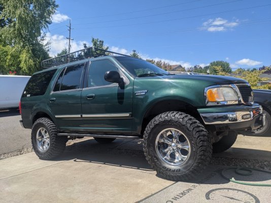

you can fit 35's with a torsion key lift and shocks.
easier than a body lift.
I am running 37"s with a little trimming.
