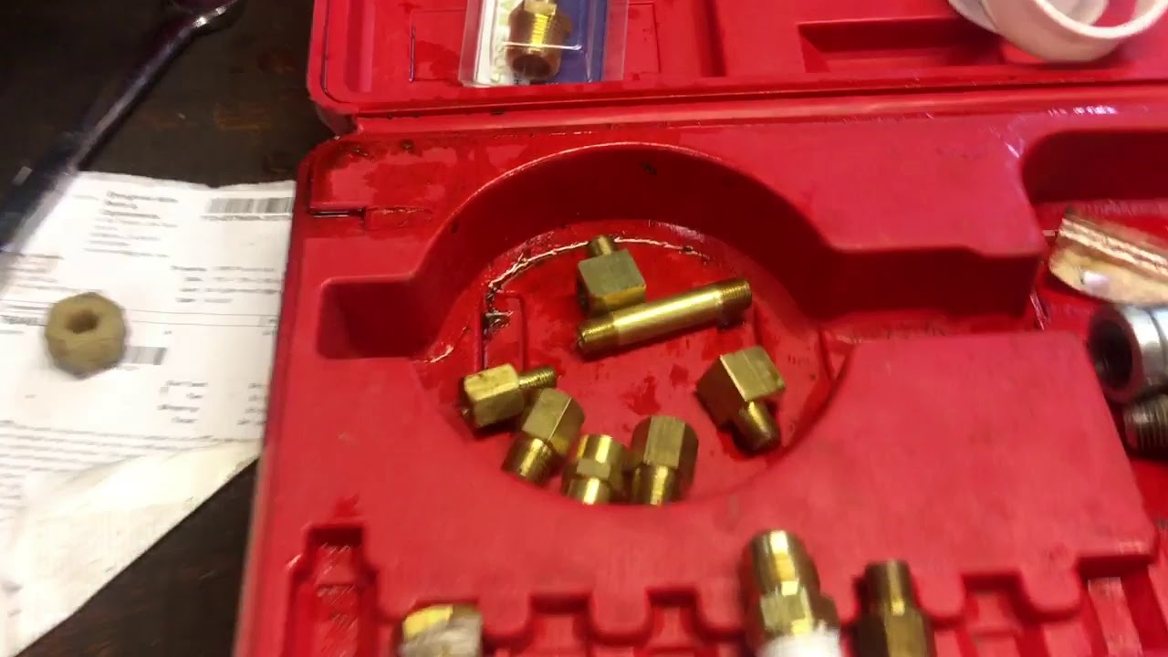

At this point is it even worth hooking up a gauge to the oil pressure sensor orifice, or is that just a waste of time? I'm thinking I should check power to the oil pressure sensor plug too.

Yeah, the motor sounded exactly like it should, no unusual sounds at all. Thanks for the recommendations. I'll buy a manual gauge and we'll see what happens.

Never any issue with oil pressure lights before rebuild. No codes are being thrown either. I just happened upon a video and it appears that this priming problem is fairly common. I am going to take a pressure reading (when my gauge arrives) and then use the priming method suggested in this video:
