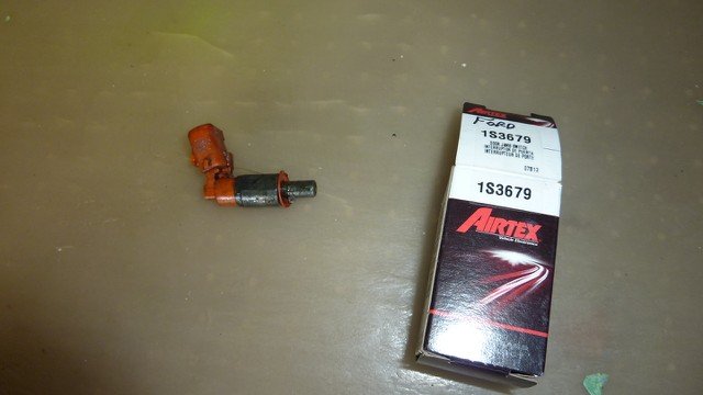

If the radio is ON and you turn OFF the ignition key, does the radio immediately turn OFF ? If so, it's most likely one of the front door jamb switches that's failed. Each door has one located at the bottom of the latch and you have to remove the door panel to access it. The two front doors will turn off the radio when they're opened. The rears do not. It's usually the driver's door switch that fails first, just due to the amount of use it gets. Be careful when ordering replacement switches because there is a different orientation for left and right sides.

Old Driver's side door jamb switch ( note crushed plunger ball ...) ....

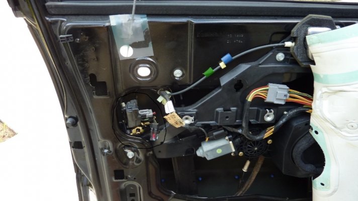

Driver's side door latch removed from door for switch replacement... quarter turn to remove switch ...

If you haven't already replaced the switch shown above you can spray each door "plunger switch" with WD40 and push the switch in and out with your fingers. I have had several older 1st and 2nd gen Expeditions and this has happened a few times. It has always worked for me. YMMV.

i guess the switch is inside , no wonder i cant see it
