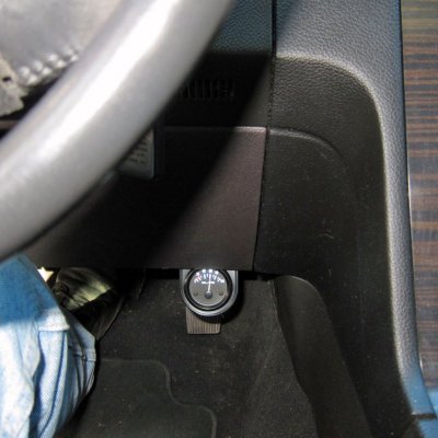

    All that CAN happen but you would have to let it go for a long time while listening to all the carnage, also 2v engines don't all have the all metal tensioners (mine didn't either and the O ring went south). I think the tensioner design was the main culprit on these engines; they start leaking, there is no real oil gauge to know, and then it all goes bad. That's why I put a gauge in mine and it has 35 psi with hot oil, in gear, idling, with the AC turned off, and it purrs like a kitten with 140k miles. I did a thread on installing one if anyone is interested.

    One little problem - you could have good oil pressure at the filter, but if there are leak paths far upstream you may have no oil in the cams. I believe this could be the case. But 35psi sounds healthy. I have an older (mid-90s) explorer, I was able to get a motorcraft sender part and the gauge responds with oil pressure (no numbers, but you could easily estimate). I think though shortly after all Ford oil gauges are digital needles pretty much.

    Do you have a part number for the sender part?
