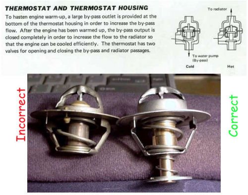

As mentioned, a properly working t-stat is important. A t-stat that only opens
partially, or not at all, will cause overheating. To check a t-stat, remove it, and
place it in boiling water to determine if it opens, or not.
