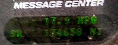

18MPG around town on 03 5.4l

At this point all that was left was the air factor. So I went to the shop at the college and ran smoke through the vacuum lines. There was the problem... Smoke poured from brake booster, EGR, lower intake, and valve cover on left side. Spent about 120 bucks fixed all this, which was relatively easy no special tools required, except Ford fuel line tool. (which I made from a sharpie lid) the result was 18ish MPG around town 25ish on freeway after 200 miles.

Gary, when I'm driving with my foot in it, I manage about 15.5 to 16.
