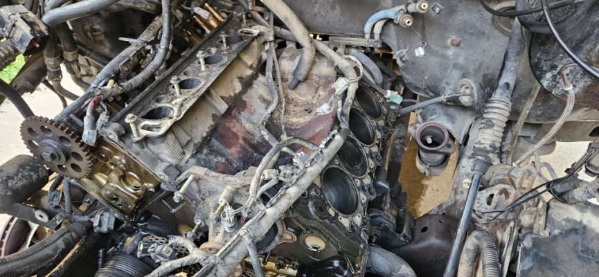

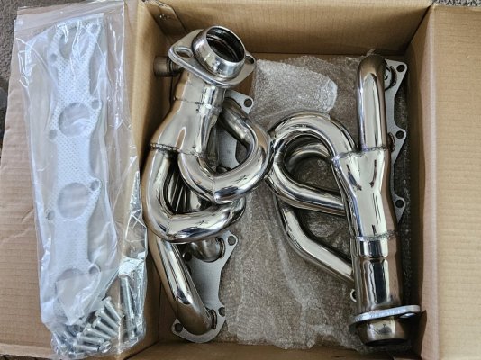

I bought a cheap set of shorty headers and started the exhaust repair. We couldn't heat the exhaust studs because the head gaskets were leaking oil so bad it was catching fire. We decided to pull the heads to get the manifolds off, clean everything up, and go back together. There is no significant wear in the cylinders. Can't even catch a lip with your fingernail at the top of the bore. Valves/ heads look ok. While pulling the passenger side head, there are signs of heat which could indicate a clogged port. Ok these heads, is it worth cleaning up as long as it's not warped or cracked?
Also, timing was at least 10 degrees retarded on the driver side cam. No apparent damage. The timing set appears nearly new with little to no wear. I think someone did a timing set and did not reset the timing properly on that head.
Also, the spark plugs are toast. The anode and cathode are just about gone on every plug. I bet they have 200k+ miles of they're not the original. They are motorcraft, so being original is not outside the realm of possibilities given what they look like.
With all of this, there's no wonder it seemed gutless.
Is it worth messing with, or should I swap the engine?

Depends on what you're going for. If it's just an off-road beater vehicle then repair / rebuild what you have. If you're going for a performance off-roader I would look for a post-2000 5.4 2V motor and rebuild that. Check the motor mounts while you have the heads off. Much easier to change with the heads off. Depending on the maintenance history of that motor how long the lower end lasts. If they never changed the plugs, how often do you think they changed the oil ?
First of all, sir. By Hamfisted, might your name elude to an Amateur Radio license? If so, N0KHP here.
Now to business at hand: I do plan to use this vehicle as a basic trail/overland rig. Maybe eventually go to some 35s but not trying to win any hill climbing competitions with it.
I have considered a 5.4L and a couple other engine swap options. I don't need to make 500hp. If I could get close to 300 lb-ft of torque in a trustworthy/reliable configuration, it would do everything I need it to do.
Current plan is to just get this 4.6 together in better shape than it was and keep running it as I decide which direction to go with the rig.

Welp, we got the top end reseal done and exhaust leak repair completed in time for vacation to Kentucky (about 2200-2500 mile total trip).
The Expy is running great, and these headers are working good for me. They discolored quickly, but I don't care about that. I'll probably buy a set from the same manufacturer for my 351w swap into my Bronco.
