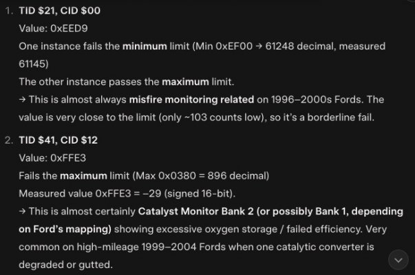

In my 1999, TIDs 21-00 and 41-12 were already out of range when I got my first scanner but there haven't been any problems so I've never pursued them. Recently, out of curiosity, I ran the Mode 6 output through Grok and got these unexpected results. Haven't dived deeper yet but those tests might be relevant to your 1998's issues.

My Mode 6 flags two issues.
1. Unknown Test TID 21 CID 0 Value 32768 Limit >=60160.00
Don't know if grok would pick this up but I'm leery of 32768 just because that's the borderline of 16-bit integers. In binary, it's a 1 followed by 15 zeroes, an unlikely reading and more likely an indication that the data isn't valid.
