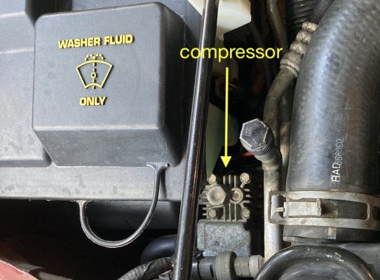

Assuming you have air shocks, could the noise be coming from the air suspension compressor?
Your description is kinda what mine sounded like until (thanks to this forum), I replaced the vibration isolator bushings. There was nothing wrong with the compressor but the bushings were toast and probably had been for years. It's way quieter now.

I don’t believe I have air shocks. It also doesn’t happen all the time. Like it’s not only when I turn the air on/off or only when I turn, put it in gear, etc. that’s why I’m struggling to figure it out because it only happens on start up, and some other times randomly. But it disappears after a few seconds and stays gone

If you don't have air shocks then this is definitely not the problem! However, every symptom you've described fits with how the air suspension operates and sounds.
Attached is a picture of mine. If yours doesn't have a compressor in the same spot, I'll bow out of the conversation because that's all I got.
