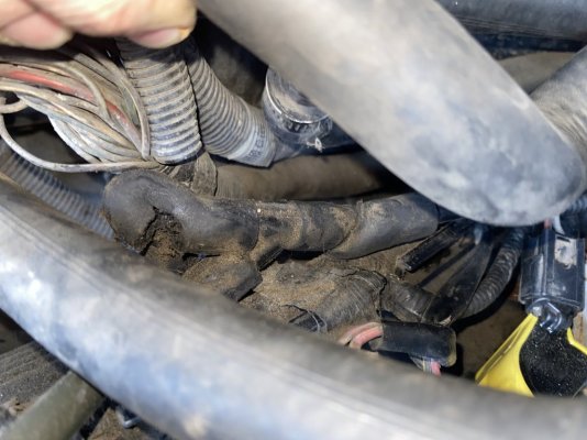

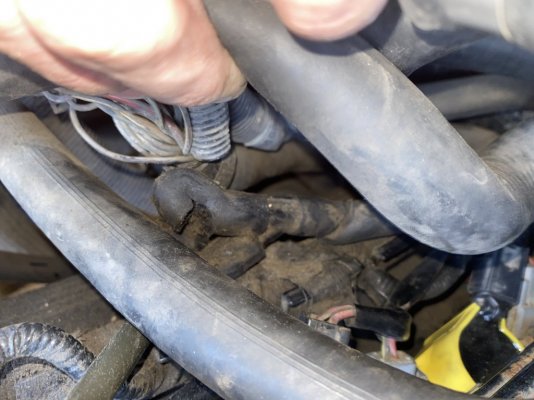

Update: I was looking in the engine bay to see if there would be anything to catch my eye, and low and behold there was. The metal line for the PCV looked somewhat kinked, so I looked at the rubber lines right on the pcv and they were completely just destroyed. I dont know if that's what would cause the issue but it's a start.

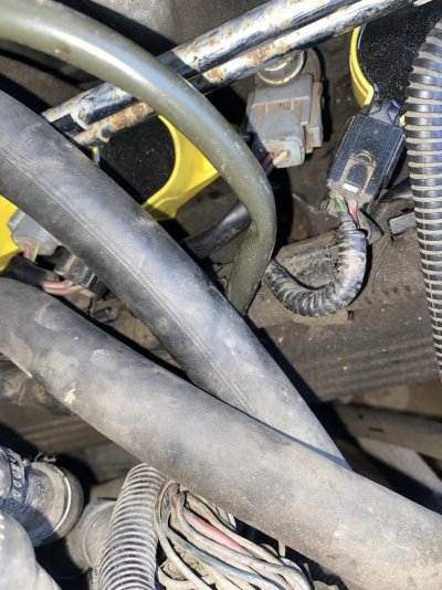

True just $100 for a small smoke machine is just wow, ill see if i can build my own a check. I only have two lines im concerned might have a vacuum leak, ill take a picture of the ones later on because im not to sure what they’re for and i need to know which ones to order. Anyways it’s kinda hard to see how messed up the rubber line is in these but this is what the PCV lines look like.
