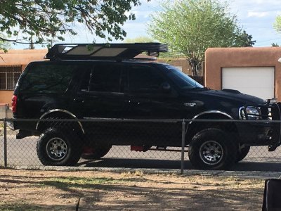

Mad Oshea
Feb 18, 2019
55
Albuquerque
I have a first Gen 1999 ex. XLT. If You looka at My truck on post, You will see the 6 inch on 4 inch boddy lift. There are no blocks in the back, but a mechanical lift. I can bag it if I need to. It will need a kit in front, and coils in the rear at 300 bucks a kit.
Mad Oshea
Feb 18, 2019
55
Albuquerque
There are no shackels on this lift, Just a mechanical., with a 4 inch boddy kit. I put 33s on it.
Mad Oshea
Feb 18, 2019
55
Albuquerque
You need to remember. When You bring a truck up like this, there are a few things to remember. You will have low mpg, low pulling rate. And You have to bring the sides out for stability. The tiers will hit on the swing, if You add spacers to the wheels. I have 2 inch on this one. They rub if I don't swing the front end. I need one inch more lift on this not to rub. It has a 6 inch lift, and 4 inch body.
