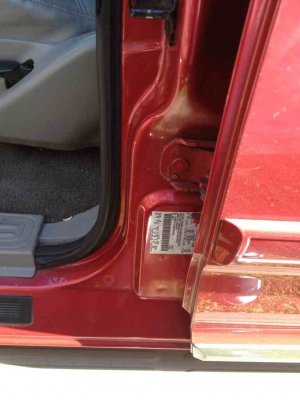

786jayone
Jun 22, 2012
23
Miami
I mistakenly thought my tags was missing also. Unroll I discovered it here between the driver and rear passenger door. I have the 2002 expy e/b with 3.55:1 code H9.
