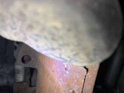

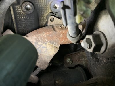

I have a knocking noise coming from my motor which seems to go away after start up and then come back after a few minutes. I have 3 videos of it: I have checked the spark plugs. I'm really hoping its not a bent rod or any of that nature. I heard it pretty good underneath by the transmission and flex plate area I think. I can change and fix parts and such, Just not a heavy duty mechanic. The third video is from underneath back by transmission.

any chance that's an exhaust leak?

I've heard guys say that, but in the third video towards the end when i was back by the tranny and I heard kind of a twinge of metal when I was recording.
