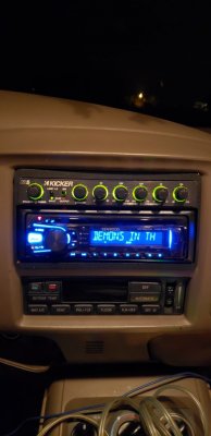

Bypassed factory amp with my head unit pushing out 50w x 4(probably better than the factory amp).

Looks like your Kenwood needs an exorcist. Replace any speakers, or still running factory?
Hell Yeah - Demons in the dirt
Just the Mach factory speakers and the two 12" crossover CF3 with Phoenix Gold amp.
