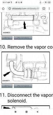

I found this diagram on Mitchell1 DIY.
XA6DyBF12Ja1DL32tzuW0Se3yxaruA7P5LGLfu6UvD5UdPs6Bg8pfEH1NIVNLj3cL73hL7SUdxKfxkqP36_GE4tiG4OyI5bH7wkL9JBxM9NFIwkzdVoEoAhNPaYeZ444faUukCX_qrBmYZtAvyC-an-TF0EiOdy4k-OAjUlw_fwb7efDPajjEo2U6yEnXBCxdYUVKSYzOjwXeHw9EWGjZdzqgfjHStxGCahMNRUl2ZYglvJKaUCAeiHKarHCQcCYD_dPDb7vEEvfbGUqw9QJJBsUMnWJyh4NYCpPE43yCJLmKgRY5lIS4WNc8qj5zLAmvEsp6zFamgCG2QmaTTWr5B5ukDlJHNJFdmtnnVeLFX57S9NGjgxs3SGCJnpEqSq_VGIQdB7QrZg1hG37WiokfPKRi7OBXun3mjxW_IfrASUqyryGGRS3Apx6VKuTI7uWya45q17ZaK_R1uW3AM90QsuIw5RPkWvbYi3jqXMNszjFux5YA0VQZ3_8L12FTNNUZxxHZFMDUCAbpjAKUD5OuJdMy22ZyIJJrMwql3XtT96cyZDj88_MYXP3j-c38rnJ7gV5IYwgIcSbBaDdtzlg0A7LIZPRiRL_YrkjzNwzBcjPz1p0OLuZk2GHETOd6fxh2P-1FNDX7g91BnaDQrDVryFvATfXLiAYgXstuWUNekjK90IK0-qHuu6mMKAdlQ=w1187-h780-no
It's the hose that the arrow is pointing at. The problem is that the end I care about, the one that is zip tied up, is the one that is going off the screen to the right. So, it does go to the vent valve, via the vapor separator (the small box with the arrow pointing left). I still don't know where this hose plugs into. And, the canister bracket from the bottom is a solid piece of metal, and it appears the bolts that hold it in place are all on the top of the frame. But luckily only 3 bolts hold it in place.
91fox, thanks for the diagrams from AllData, I might just get a sub to that one as well. I have Mitchell1 DIY for this vehicle, but looks like you have a few more diagrams than I do. Thanks.

I feel like that hose is a vent. I'm not entirely sure that it plugs into anything at all, however, if you find out otherwise please do post. I'm having some weird issues of my own lol
