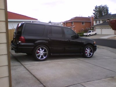

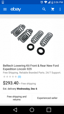

I have a 03 XLT, I dropped mine with the belltech 3814 at around 60,000. Now I work as tech for dealership so I had a lift and a air spring compressor. But you can do it your driveway, If I was you removing the the spring and strut assembly as one and marking them. Such as l/f ,r/f etc. Then take them to shop and have them seperate the springs and install the lowering springs. Then you can install them as a completed set. You don't need to replace the strut unless it's leaking or weak. The rear strut is going to take time because, the 3 upper mounting bolts your going to have use a wrench to remove them. Because if the space issue, and the lower mounting bolt is pretty big so you have to buy one. If you have access to air tools it will go alot faster, but just using hand tools it will take awhile. I suggest having several long breaker bars too. I also have the rear belltech sway bar. It took me about 3 1/2 hours to do it in the shop. Good Luck
