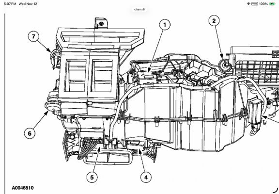

Is this the driver's side actuator?

On the dual control ac units the passenger side blend actuator is on top and can be replaced with the dash in the car. The drivers side blend actuator is on the bottom of the hvac box and the dash has to come out as well as the hvac box. Number one is the passenger side and number 4 is the drivers side. Below
Thanks AWAR! When you say the dash has to come out, do you mean the dark section around the gauges and stereo, or do you mean the whole dashboard (the tan part)?
Also, how long and how difficult it it to remove the HVAC box?
Thanks!

The complete dash then the hvac box. Discharge the a/c and all that entails. It is a real pain and a long process.

It’s not that complex, nor required the entire dash or the airbox to be removed. You have a blend door actuator up top, and a mode select actuator (IIRC) on the bottom. I’ve personally replaced them both.
The blend door actuator up top can be done in about 30 minutes. Ford Tech Makeyouloco has a great video on it. You’ll need a ratcheting-wrench, 8mm if memory serves me.
Replace with quality Motorcraft parts. You won’t want to have to do it again after the Dorman parts fail. It’s really not that bad. Good luck.

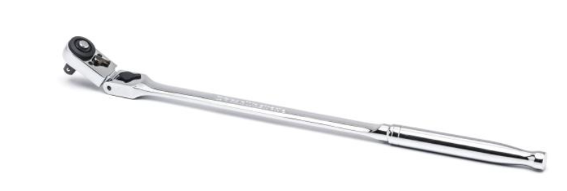

Well it's my turn to replace the lower front actuator. I'm gonna try to do a little write up with some pics to help in the future. I have everything out except 1 screw. It appears the lower/floor duct needs to come out and there is 1 screw in the middle in the back holding it to the plenum that I cannot get to. Once that's removed it looks the actuator will drop out and maybe this job can be done without removing the dash and discharging the A/C. It's like 8" from either side, but access is really only possible from the passenger side. I have my borescope in there so I can see. I can get my 1/4" ratchet on the bolt, but then I can't turn it.
@kep5niner how did you manage to get to the screw in the middle back that holds the floor duct to the plenum?

I got that screw out, needed a long thin 1/4" ratchet to reach it and even then it was a struggle. It's not a very impressive ratchet, the 72 count tooth kinda sucks, but it does have a locking flex head and it got the job done. It's 12.5" long. My longest 1/4" ratchet was 7". The only wrench I have that would reach it my offset 8mm wrench and would just barely reach. Despite it being a 12 point wrench I got it on and loosened, but could not get it on and able to turn it again.
