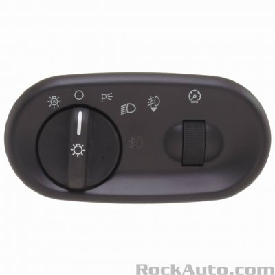

I changed the switch but all the troubles are still here.

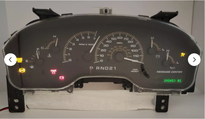

I thought of the instrument cluster. Do you think that it's a good idea ? Do you know if my model needs a reconfiguration of the dashboard (thanks to a toolkit) if I changed the instrument cluster ?

Have you checked the bulbs ? Like with an ohm meter for continuity ? Or did the instrument lighting all of a sudden quit ?
If you need instrument cluster bulbs you can replace them with LEDs pretty easy. Are you getting 12v at the parking light sockets ?

Checking of the instrument cluster bulbs in progress
