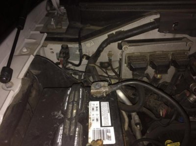

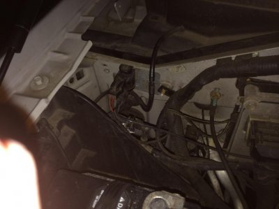

6k, I tried to run the power cord through every crevice and hole near the battery, all of them led to under the car rather than inside. What should I be looking out for?
14,561
888
Hampton, VA
pop ur hood...take a pic...post it here...if u can...get someone to hold a flashlight in the corner where the 3 connectors of wires are at...looking under the hood top left corner...then u get on the floor of the passenger seat and look up in the corner...need to do this at night or darkness of the garage...thats how i found it...installing at night and i saw the light from my garage...

Attached some pictures of the battery area. I did try shining a flashlight in the dark and didn't see any light under the glovebox.

damn sorry dude...my 04 isn't set up like urs...u must have 1st run 04 that was actually made in 03? if u can wait till around the 23rd of jan i'll post pics when I get home...sorry
