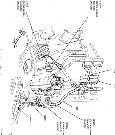

I suggest if you have a sunroof the front right drain is leaking. That drain runs down the A pillar. You can open the sunroof and look into the corners to see the ~3/16" drains. Use some lawn trimmer string to push through the drain and see if it's plugged up. If you don't have a sunroof check to see if the roof rack is leaking. The other possibility I suppose is the windshield.
I would disconnect the battery and then remove the fuse box, aka central junction box, to inspect it for corrosion. Also check the ground connection to the body at the fuse box. it sounds like this issue is not new so corrosion is a real possibility.
This thread has lots of great info for the fuse box:
This is for a 2004, but shows the connectors to disconnect, yours will be very similar. There's also a few nuts/bolts.

Thank you for all the helpful replies. I had taken my truck to a mechanic that specializes in electric and he found that the fuse box was indeed gone, too much corrosion damage and internal damage. Spent $200 on getting it replaced and he said most of the error codes are gone but the instrument cluster has to be replaced now as well, possibly died from low power for too long (called it like brownout or something?). Working on getting this replaced next.
