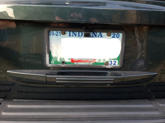

My camera bracket is behind the license plate and screwed in with temper resistant stainless screws. It requires a bit of effort to get the plate off for the average joe and the wiring I have secured inside the shell of the hatch and used adhesive mounts with zip ties in several places to essentially lock the wire in place should someone or a rouge car wash manage to tear something off so that it would minimize damage to interior wiring and likely just rip the camera body off its wire before causing any other issues. Its small and doesnt draw much attention. Pic attached showing it mocked up before securing everything and changing rhe mounting hardware.
