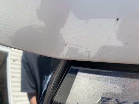

Hello Group,
I have a nicely equipped, low-mileage (39 K) 2014 XLT version of the Expy that we've owned for about 2-1/2 years. It was a one-owner vehicle, housed in Beaufort, TX. We bought it on-line and had it shipped to our home in Troy, OH. We're very pleased with the vehicle and it is well maintained and garage kept. Today, while performing a thorough cleaning of the vehicle in preparation for a trip next week, I noticed some corrosion on the inside of the lower edge of the liftgate (not noticeable from outside). I was shocked to see this but have learned this evening while searching the archives that it's a common problem on this aluminum part. Fortunately, I have discovered the problem early (I believe). There is one dime-sized spot where the paint has bubbled off and one other similar but smaller spot and I can see a bit of other bubbling under the paint along the inside of the lower edge of the door.
My question: What can I do to arrest the corrosion and prevent it's spread too the outside of the liftgate? Any and all suggestions are greatly appreciated.

Known problem for years with Ford vehicles with aluminum body panels - Ford refused to identify the root cause and correct the manufacturing defect.
Good luck.

Hmm; noticed some white dime sized corrosion under the lip of my hood. I wonder if scraping and sealing with epoxy would stop the progress?

On my 2009 I had the hood and tailgate stripped and repainted by a very high end shop. Still came back in about 2 years.

I had a couple spots on my hood and lift gate edges when I bought my '14 EL LTD, w/80K miles in 2018. I just left them alone, haven't done a thing to thing to them and they look the same as they did originally. I'm hoping they don't get worse...
The high end shop near me said they wouldn't touch the panel and would only replace and spray a fresh panel for the very reason you experienced.
I ended up sanding down and bedlining my rear hatch. No issues since.

My 2011 has it around the wiper mount on the rear liftgate. I've got pearl white paint on that truck, so not looking forward to having it redone.

The only way to stop the corrosion and to fix the paint problem, is to strip the paint off, sandblast and use an aluminum etching primer found in a marine supply store. Then paint it. A good body shop should know this. My aluminum hull boat was done in 2004 and spends most of it's life in saltwater, to this day no issues.
