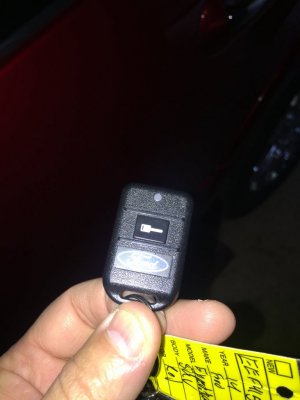

It is a stand alone key fob, I'll get a picture of mine, I drive a 2014 as well

This is what I had to get, got it from eBay, easy to program to, you need to find the box under your driverside dash, it will have a button on it valet , put key in ignition turn to on, press brake and push button in till the horn or door locks move, the let off and push the key fob. It should work, you may have to look online to see if I'm right for sure. Need any help let us know
