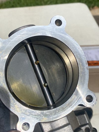

My 2016 with 106k miles has developed an intermittent power loss while driving. No codes, no misfires. Started about 2k miles ago. Does not matter the speed, the RPM goes to idle, and within seconds the power returns. May happen consecutive times and then the symptoms vanish for many days. I’ve been researching the internet for weeks and fellow DIYers seem to be throwing parts at the problem without updating once the issue is solved (I’m also guilty of this).
Today I inspected the throttle body and noticed black specs that seem to be carbon. I’m not sure if this is the issue, but it seems plausible. Look closely at the picture and you’ll see one big spec and some pepper flakes.
Curious if anyone has already been there, fixed it, and can clue me in as to what to do next if the symptoms return. It could be SO many things, and has been a real challenge to self-diagnose.

I think I've heard of this stemming from a fuel pump failing. Try searching for those symptoms. The throttle body failure is also common, but I think it usually throws a code.

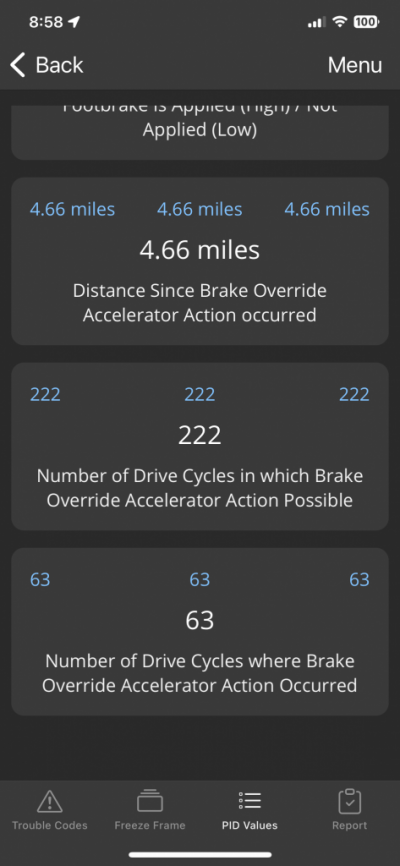

RESOLVED - 2016 Ford Expedition intermittent loss of power. The issue was a failing brake light switch (FORD OEM BL3Z19E624B) that triggered the brake override, and was a 10 minute job to replace the switch. (FWIW - this part is righty-loosey, lefty-tighty.)
Updating this thread with the solution to benefit others who may experience this issue. Firstly, thank you all for the suggestions. A second symptom arose that led me to finding the issue, which was the brake lights occasionally staying illuminated while the vehicle was parked and locked. Additional troubleshooting included manipulating the brake pedal with my hands, which had no effect. Then I cycled the ignition switch while standing outside the vehicle and the engine started without the brake pedal depressed. The computer believed the brakes were being applied while parked and while driving. I looked at PID values using OBD Fusion to confirm this was the issue. (See attached - Distance Since Brake Override Accelerator Action occurred, Number of Drive Cycles in which Brake Override Accelerator Action Possible, and Number of Drive Cycles where Brake Override Accelerator Action Occurred). The brake override safety feature felt unsafe while trying to drive normally, so my family is happy the issue is resolved.
