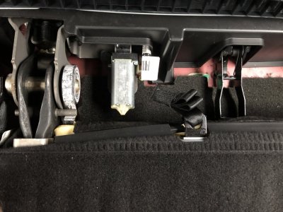

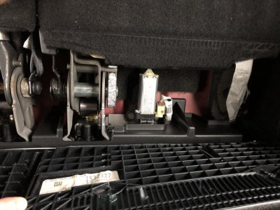

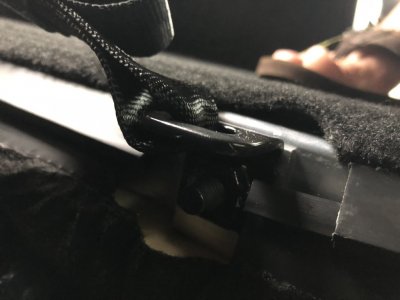

4D296D53-D0B3-487A-ADA8-DA3891E7B6B8.jpeg 38221481-2A1F-497A-B22B-684479615976.jpeg 03A8A69B-1149-487C-B582-302CD93A63D4.jpeg Thought this might help shed some light on how the single factory tether is attached to the seat back. It’s basically bolted on to the steel frame, which runs the full width of the seat. I, personally, would have zero qualms about popping the seat back cover up, drilling another hole, and using a 90-degree angle bracket, grade 8 bolt, and a short sewn runner (used in mountain climbing and rated to take a massive amount of load) to tether a child seat anywhere along that frame.
Alternatively, I would drill a hole in the actual steel hinge the seat is bolted to the floor with and do the same. Only way any of that is moving is if the entire seat breaks free of the truck.

View attachment 27105 View attachment 27106 View attachment 27107 Thought this might help shed some light on how the single factory tether is attached to the seat back. It’s basically bolted on to the steel frame, which runs the full width of the seat. I, personally, would have zero qualms about popping the seat back cover up, drilling another hole, and using a 90-degree angle bracket, grade 8 bolt, and a short sewn runner (used in mountain climbing and rated to take a massive amount of load) to tether a child seat anywhere along that frame.
So, thank you for these pictures. Thank you very, very much. I am going to take these to our car mechanic, if we buy the EL. He has little kids too, and understood what I meant by "top tether" and said he was willing to look at the car and what I needed. This was much better than the reply I got from the 4 ford dealerships I called. I'll also show it to my husband. He might be brave enough to do this, whereas I can paint, bake a very cake and garden like a boss. I don't weld though. Ha.
